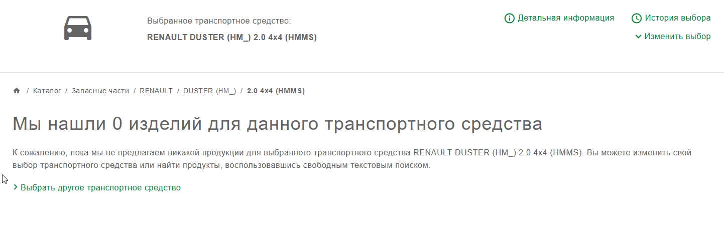

Spare parts for RENAULT DUSTER (HS_) 2.0 4x4
