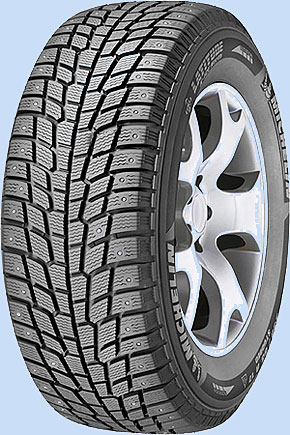

Michelin Latitude X-Ice North 205/70 R15 4590 руб
